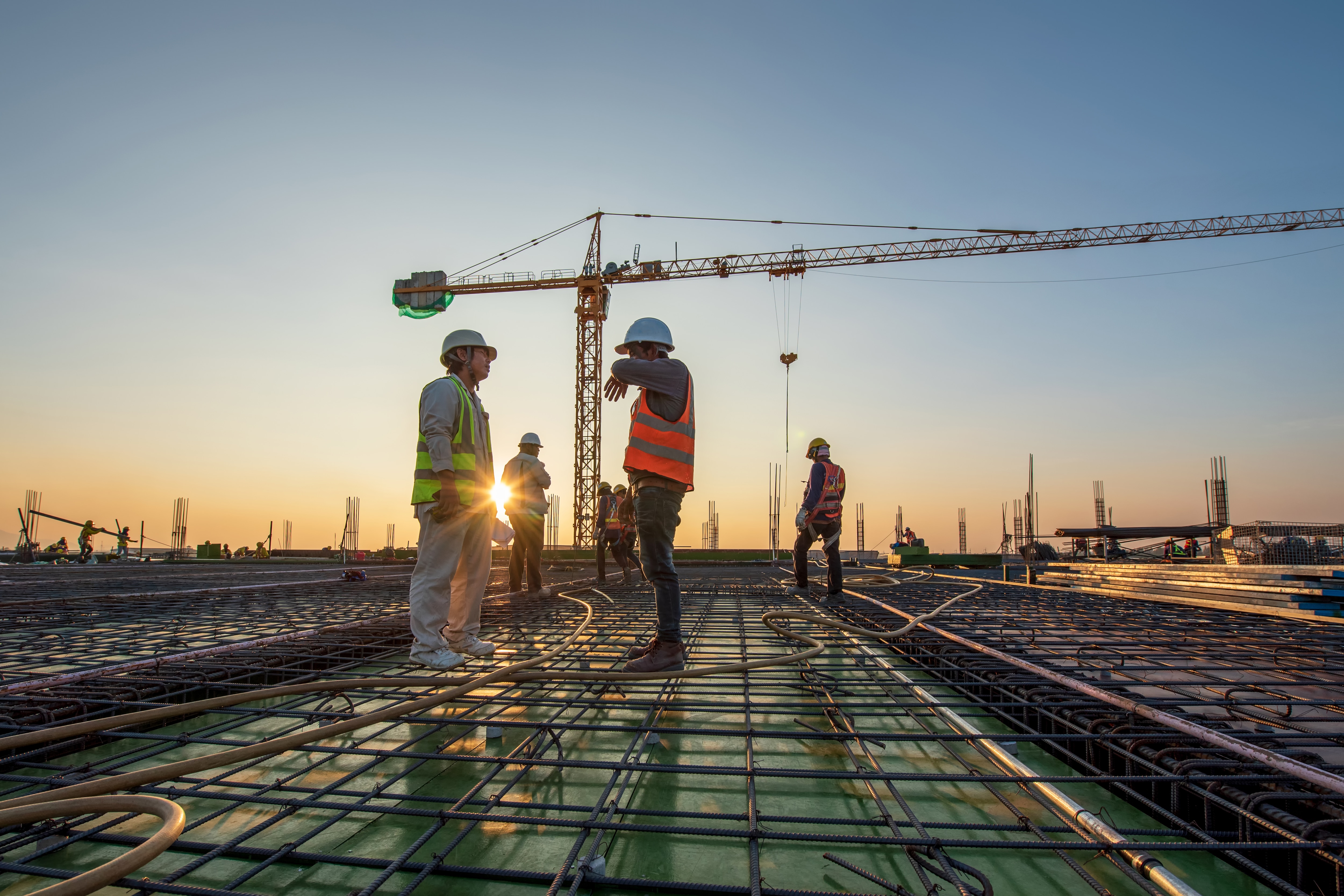

Post-installed rebar can be used to build most connections on site – for instance, walls, slabs, beams, foundations or supporting columns. The full process can be tedious and time consuming but you can overcome these challenges with our end-to-end solutions for a safer, faster and more reliable installation. Our solution starts from rebar design to meet local regulations, selecting the right products, and installation with the latest technology. Read on to find out how you can increase performance and productivity with Hilti.

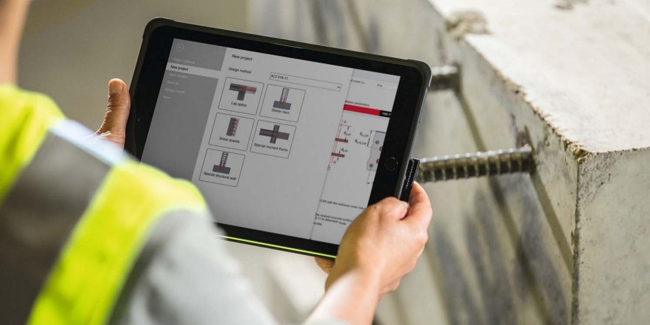

Quick and economical design of post-installed rebar
PROFIS Rebar detailing software

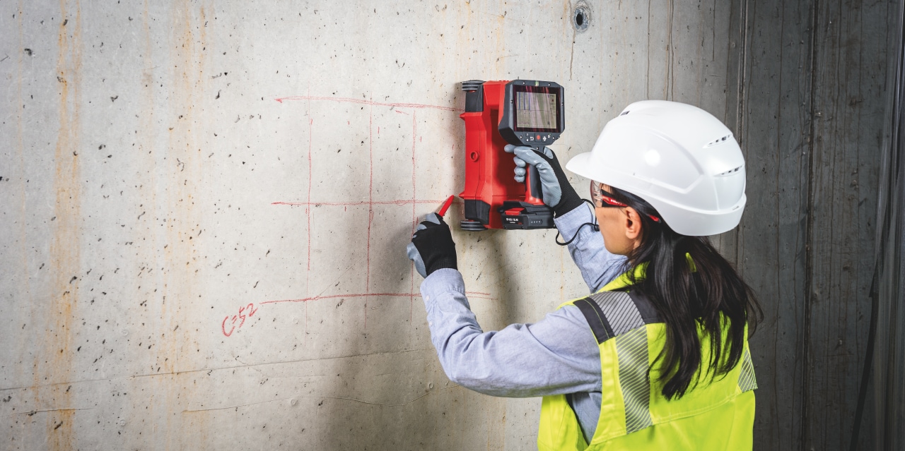

Detection
Complete rebar layout for easy onsite decision making
Concrete scanners

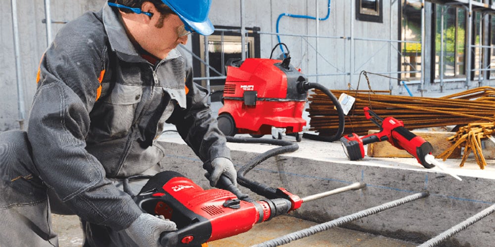

Drill/Clean
Up to 2 times faster drilling with SafeSet system
Rotary hammers Hollow drill bits Vacuum cleaners

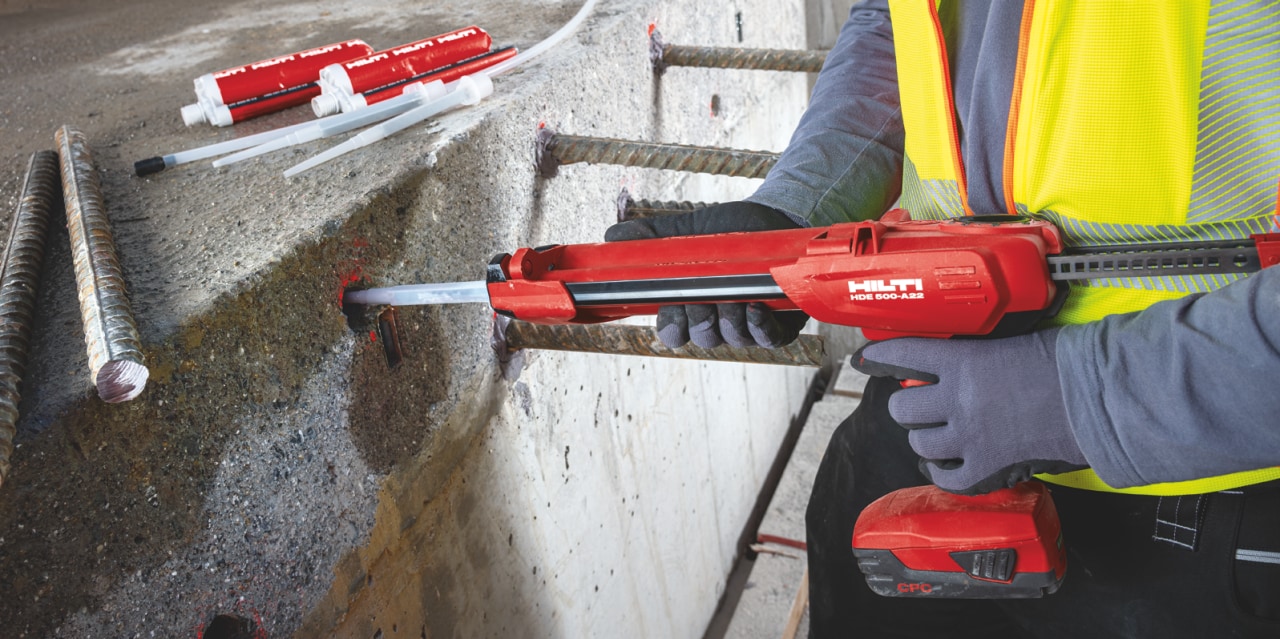

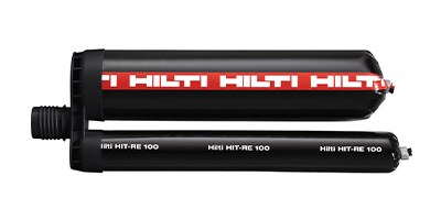

Inject
Minimise wastage with the Hilti Volume Calculator app
Cordless dispenser Injectable adhesive anchors

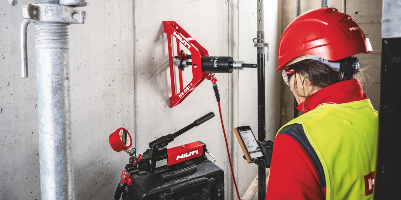

Onsite Testing
Determine the right anchor system
Onsite Testing Service

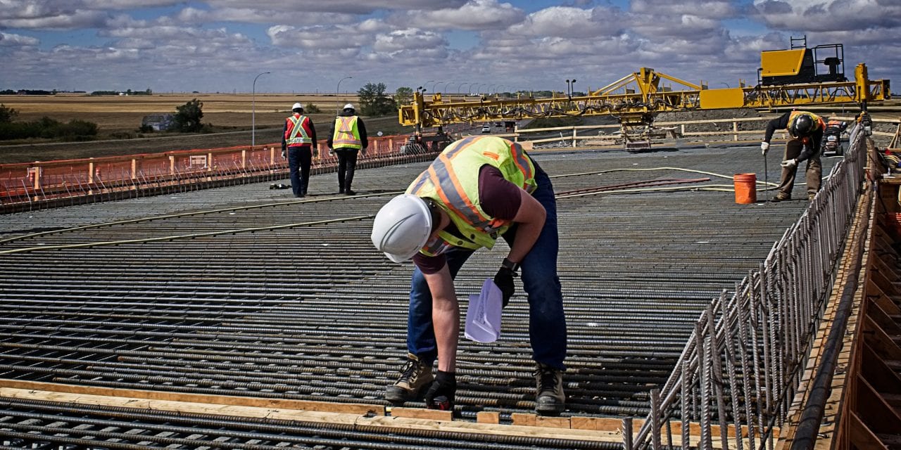

COMPLIANT DESIGN

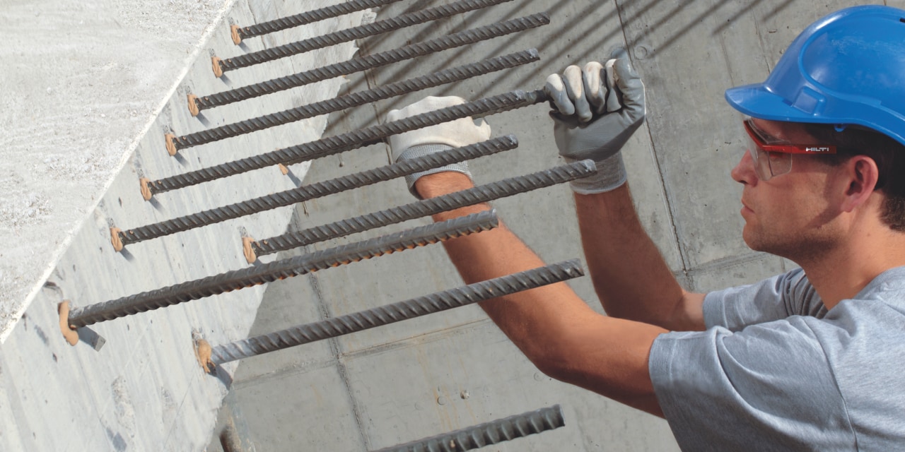

Post-installed rebars are used to connect two concrete members and is an essential application in building construction and infrastructure projects. Rebars become part of the structural system and must be designed as carefully as the entire structure. While European Technical Approvals prove that in basic load situations, post-installed rebars behave like cast-in bars, number of differences needs to be considered in special design situations such as fire or load cases where hooks or bends would be required for cast-in anchorages. The task of structural rebars is to take tensile loads and since concrete failure is always brittle, reinforced concrete design assumes that concrete has no tensile strength. Therefore despite the application, all rebar applications must be designed.

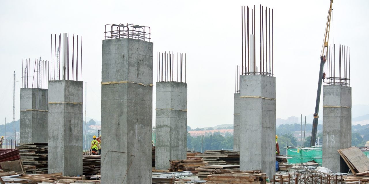

Column Connection

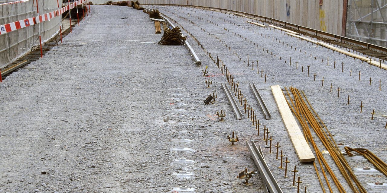

Road widening​

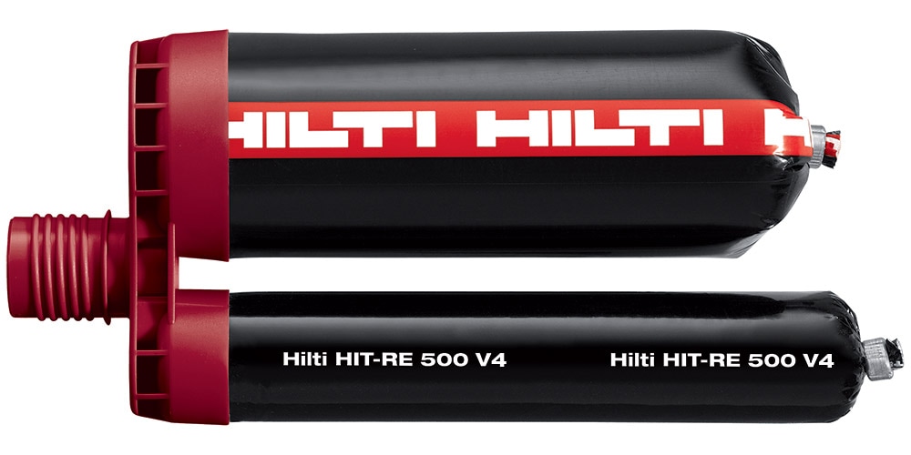

APPROVED PRODUCTS
  • Ultimate performance for demanding applications
    Ultimate
    • Highest overall productivity and safety benefits
    • Highest reliability in toughest conditions such as fire, seismic, corrosion, & more
    • Complemented by world-class engineering and software support
    • Most optimised designs
    Premium performance for a wide range of applications
    Premium
    • Premium performance for a wide range of applications
    • High productivity through Hilti system solutions
    • Impressive versatility and reliability
    • Cost-effective solution

Now you can design and install 'post-installed' rebar connections with more confidence. Inadequately cleaning holes during installation can reduce the performance of conventional chemical anchor systems significantly. Hilti SafeSet™ Technology eliminates this factor almost entirely – in both cracked and un-cracked concrete with post-installed rebar.
Learn More
Which Cleaning Method Do You Use?
TRADITIONAL METHOD
What is the "Blow twice, brush twice, blow twice" method?
This traditional method can be used with epoxy and hybrid chemical anchors.
However, the process can be time consuming and leave more room for error.
What do you need?
  • Wire Brush
  • Air Compressor / Blow-out Pump

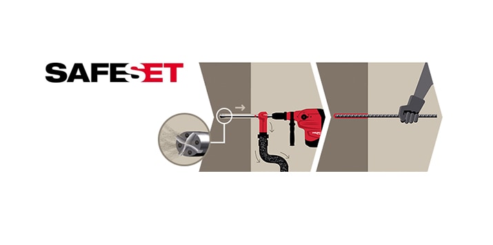

Safeset method

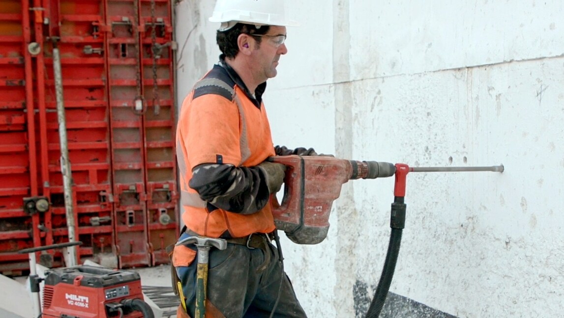

What is the Hilti SafeSet cleaning method?
SafeSet is a proven system that automatically cleans the hole as you drill. This more efficient process requires a Hilti hollow drill bit and an appropriately sized Hilti vacuum cleaner.
When used correctly, SafeSet can save you up to 45% of the installation time.
What do you need?
