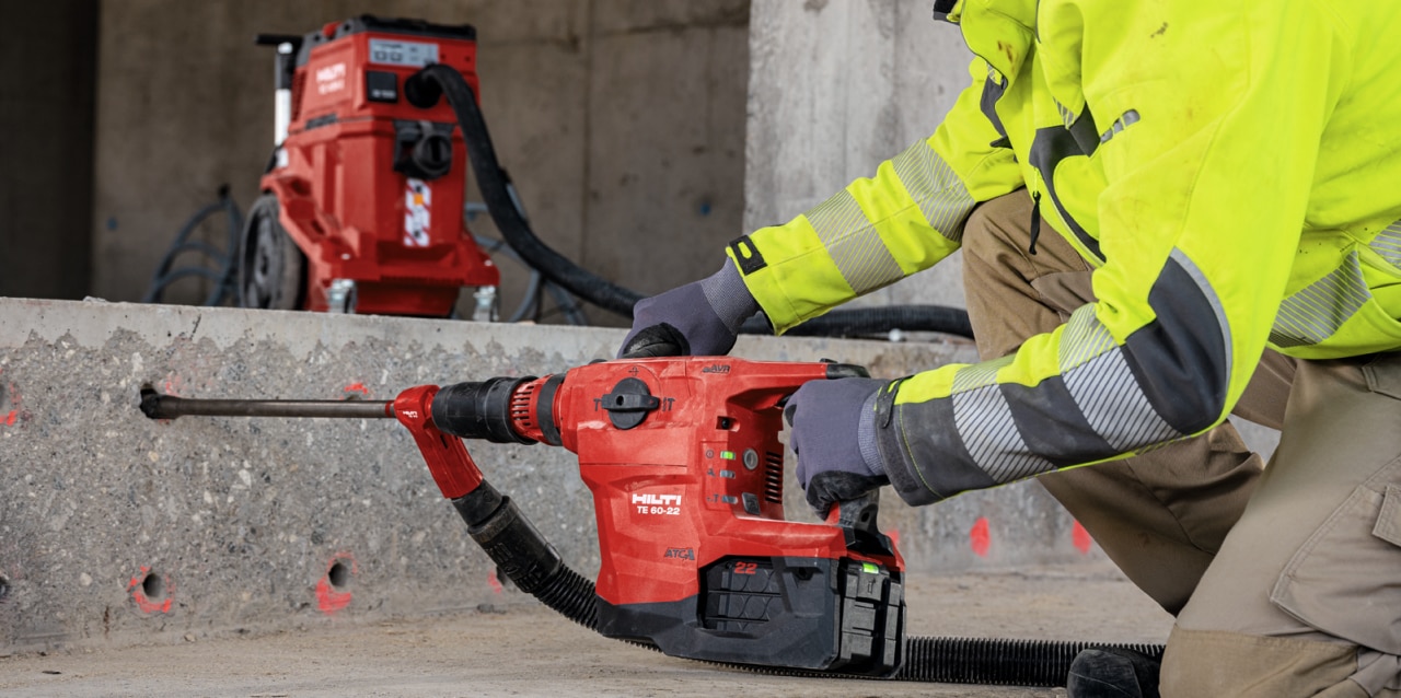

DRILL
Drilling for rebar
Drill faster and safely with Hilti combi-hammers and extra-rugged Hilti hammer drill bits​
 ​Hilti TE 30 has Active Torque Control (ATC) stops the tool body from spinning uncontrolledly if the drill bit jams.​
