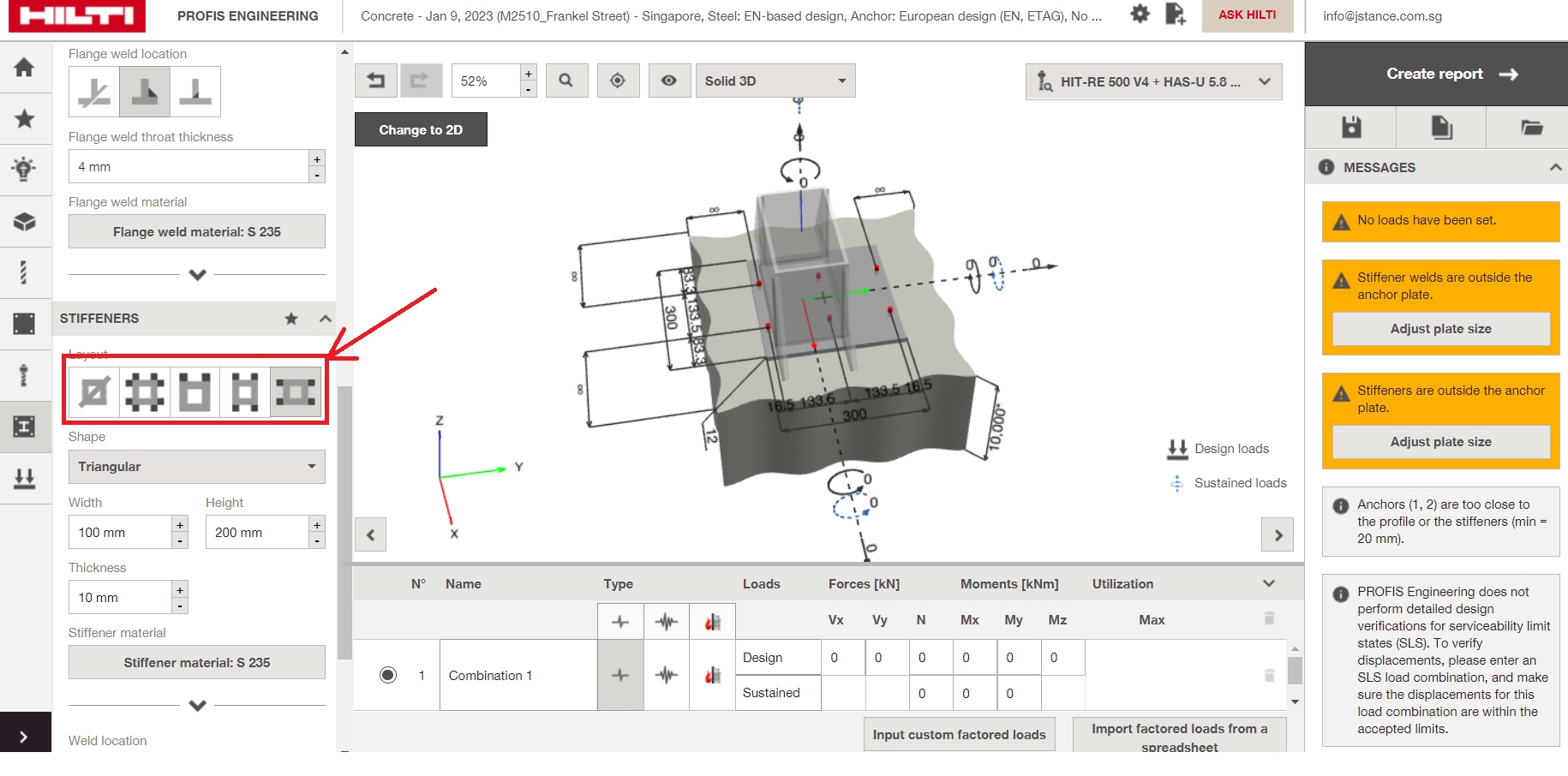

HI. Is there an option to customize the shape of the stiffeners in Profis?

Hi John,
Thanks for your query.
Yes, we do allow the user to change the shape of the stiffener. There are 3 shapes available: Triangular, Rectangular and Chamfered. As per the attachment, the stiffener shape required is chamfered. Please see the image below to select chamfered shape of stiffener.
Please feel free to reach out to us in case of additional queries.

Posted by JSTalmost 4 years ago
Dear Hilti,
The customization function of the stiffener plate seems to be missing.
The current standard stiffener position is of undesirable location.
Please solve the issue.
Thank you.
