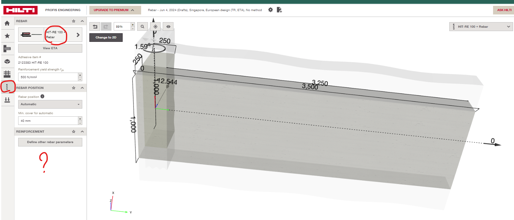

Where can I put the reinforcement detail (Layers, bonding, diameter,...) for post installed rebars if I use HIT RE-100 +Rebar?

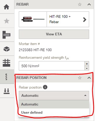

Hi Eejiet Kong,
Could you please input a shear load to firstly trigger the "Automatic Rebar Position" function.
Subsequent, please select User Defined if you would like to customize your rebar (i.e., size, spacing etc)
