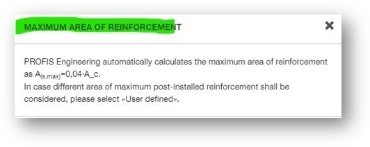

Does profis engineering considers limiting factors for structural members (beams, columns girders) such as maximum/minimum steel area specifically for concrete to concrete connection?

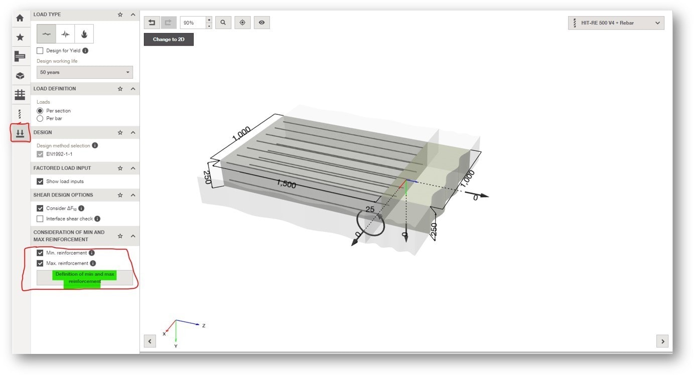

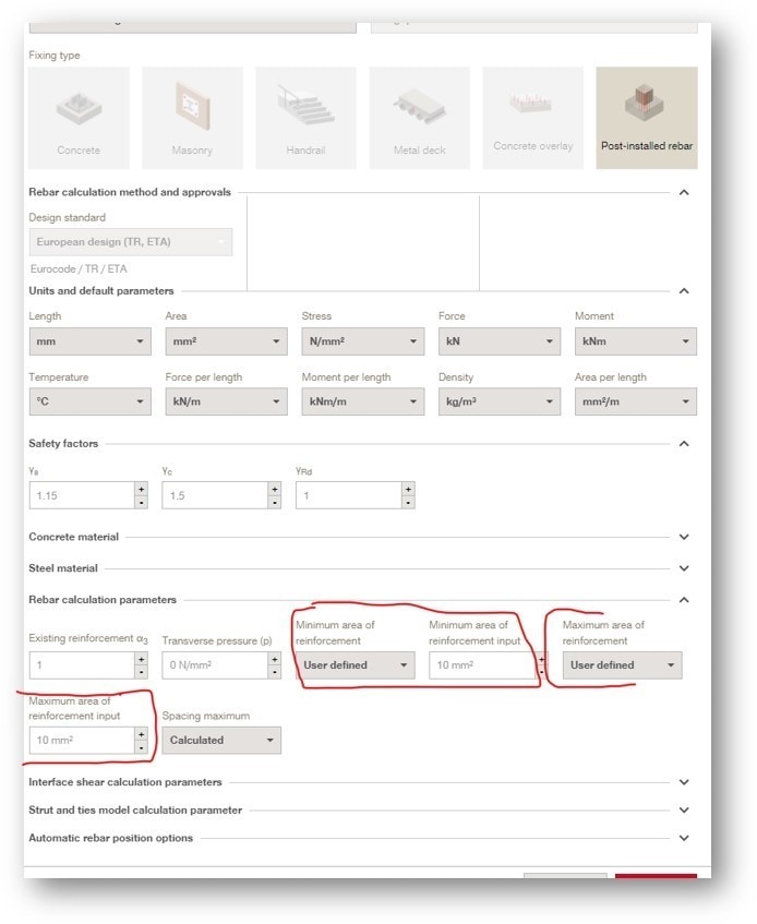

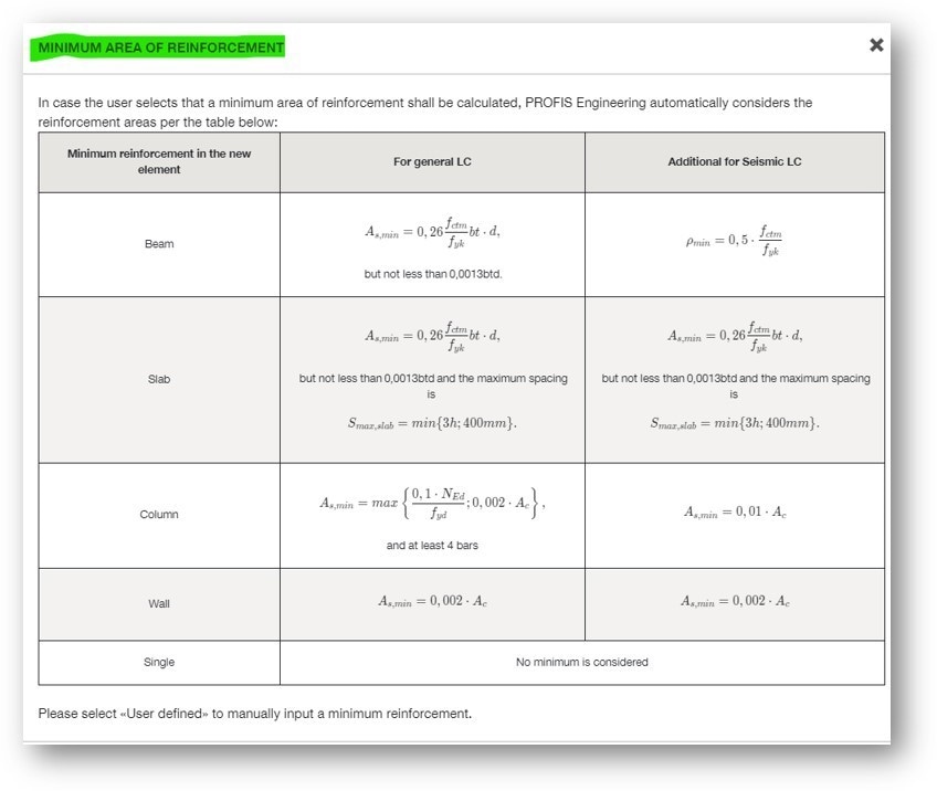

Hi Julius,
In PROFIS Engineering (concrete to concrete connection) we have the option to select the minimum and maximum reinforcement requirement check (which is based on the EN 19991-1-1-2004), we can also manually enter
the value of minimum and maximum reinforcement from the setting option.
Please refer to the attached snapshots where you will get this option.
