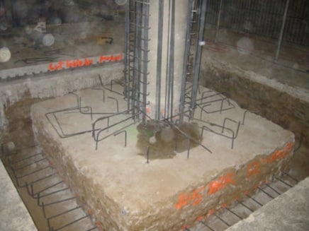

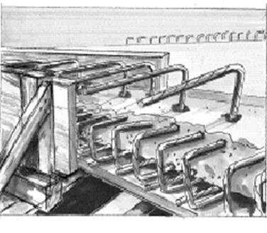

Hi Mahalakshmi,
The L-type of rebar can be installed in existing concrete to be used as shear connector to connect the new concrete. Only 1 side of the L shape rebar can be installed in the existing concrete while the other will be embedded in the new concrete. Please find attached the examples of the application.

Posted by Mahalakshmi Shankaralmost 5 years ago
Thanks Karan..that was helpful..
