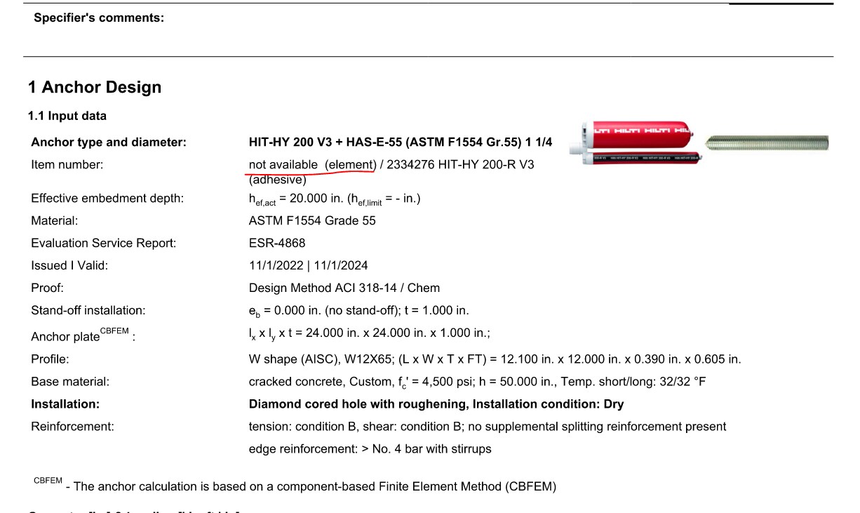

Please refer snap, I am designing this anchor its safe in design but in report, its showing not available element. is this specific anchor with effective embedment is not available.

Hi, Nitin,
Thank you for reaching out to Hilti.
With the available embedment depth, the standard item number is not available in PROFIS software.
1 ¼ in dia rod with 20 in embedment depth can be used after consulting with the Account Manager of Hilti who visits your job site on a regular basis.
You can also connect with HILTI customer service for more information.
