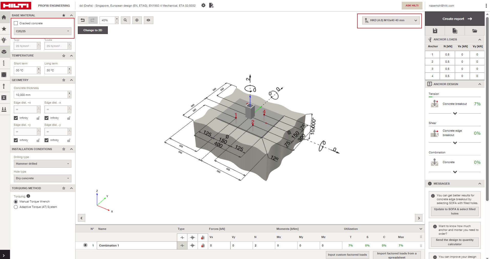

Yes we can design with HKD-drop in anchors in PROFIS ENGINEERING, you can select this anchor by selecting uncracked concrete in Profis (see image attached) and then select HKD anchor. HKD anchors are only approved for uncracked concrete for structural applications, refer ETA attached here for more details .
