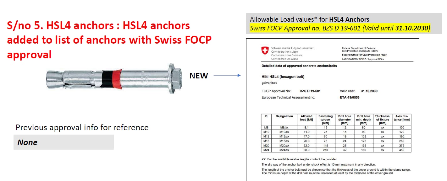

Contractor would like to clarify the following : (Refer to printscreen)
  1. Axial Distance on table is referring to?
  2. Allowance load = design load?
Clarification of Hilti CD anchor design,Allowable load = design load in CD table

Axial distance refers to minimum distance between two anchors.
Allowed load refers to maximum allowed load on a single anchor.”

Hi Khanna, does that mean axial distance supersedes what is the minimum distance stated in the technical manual/ETA?
