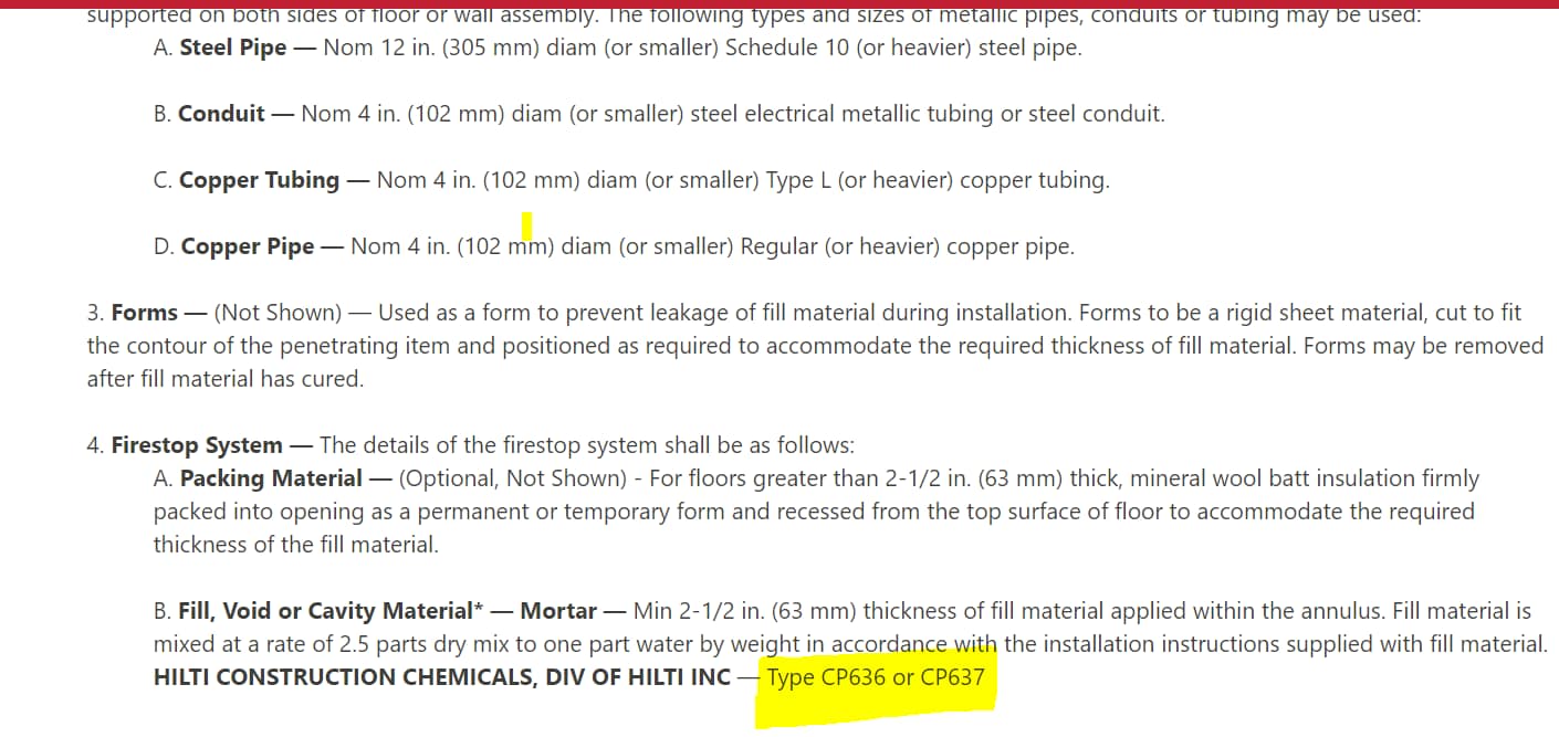

Base material is RC. CP636 is out of stock so was thinking to use CP637 instead.
What advantage does CP637 has since it can be used for load-bearing applications?

Hello JC,
Yes, CP637 can be substituted for CP636. Refer below snapshot from a UL certificate (C-AJ-1140) that indicates the same.

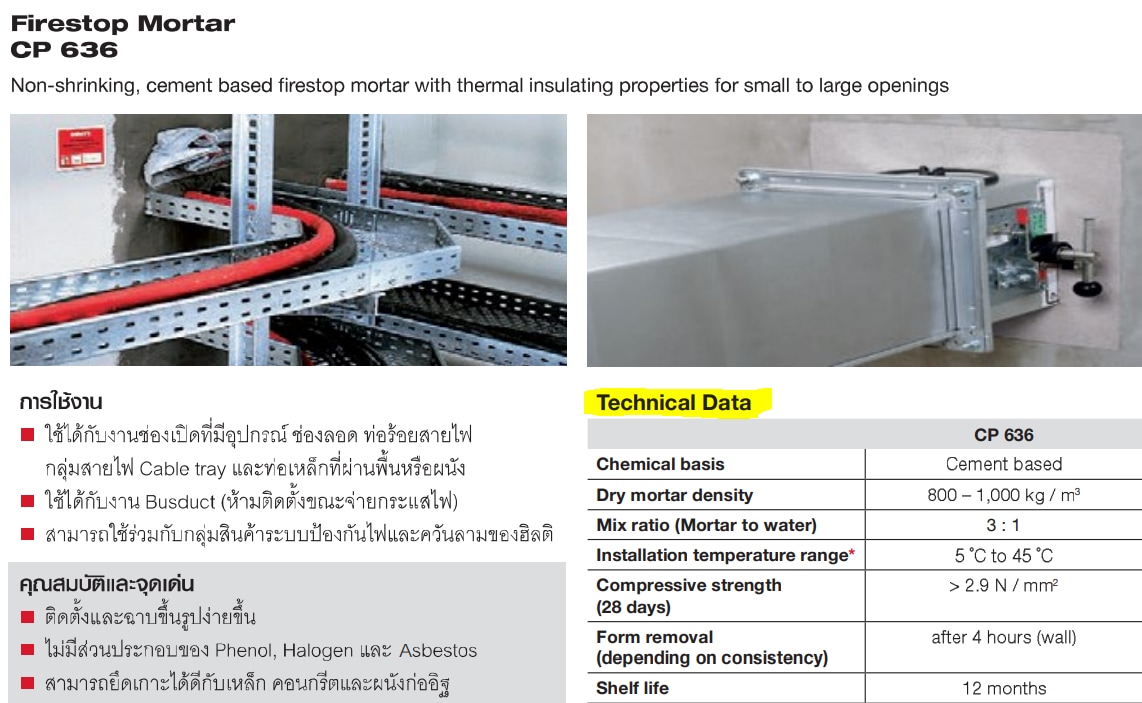

Regrading the comparison b/w the properties of CP636 and CP637 you can refer below snapshot for their technical properties. CP637 is a high strength firestop mortar.
