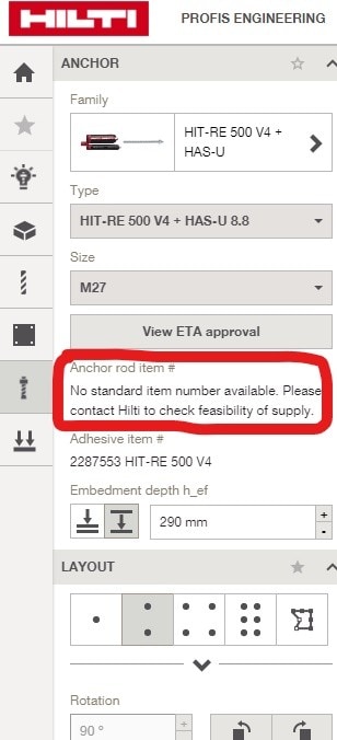

I was designing some steel-to-concrete connection using HILTI PROFIS Engineering. I wanted to use HIT-RE 500 V4 HAS U-8.8, two M27 anchors with 290mm embedment depth for the connection. It passed the check but showed no standard item number available. What does that actually mean? Can I still use this anchor with the embedment depth?
Embedment depth,available

Hello Jason,
Thank you for reaching out to Hilti.
With the available embedment depth, standard item number is not available in PROFIS software. M27 dia rod with 290 mm embedment depth can be used after consulting with the area manager of Hilti which visit’s to your job site.
Kindly contact with the area manager or you can raise a request through website online.

Attached is for further illustration
