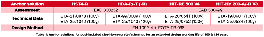

Table 1 provides an overview of selected anchor solutions for post-installed steel-to-concrete fastenings with extended design working lives:
Anchor solutions for post-installed steel-to-concrete fastenings for an extended design working life of 100 & 120 years
Designers must consult the current versions of the ETAs to confirm the permitted design working life, exposure conditions, installation parameters and limitations for each product.

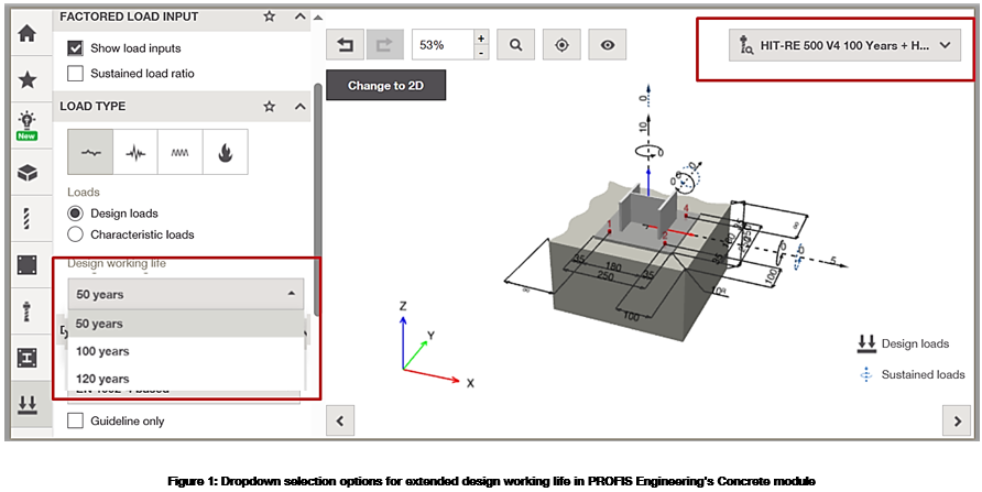

Hilti’s cloud-based design software PROFIS Engineering introduces new options to support designers in selecting and designing post- installed fastenings and connections in concrete in accordance with European design standards and the corresponding ETAs.
Within the PROFIS Engineering Concrete module, users can select extended design working lives (for example 100 or 120 years) for post-installed fastenings in concrete via a dedicated dropdown field (Figure 1). This provides a design model that is consistent with the chosen working life and the corresponding ETA for the selected fastener, as highlighted by Figure 1 for post-installed fastenings in concrete.
Baseplate

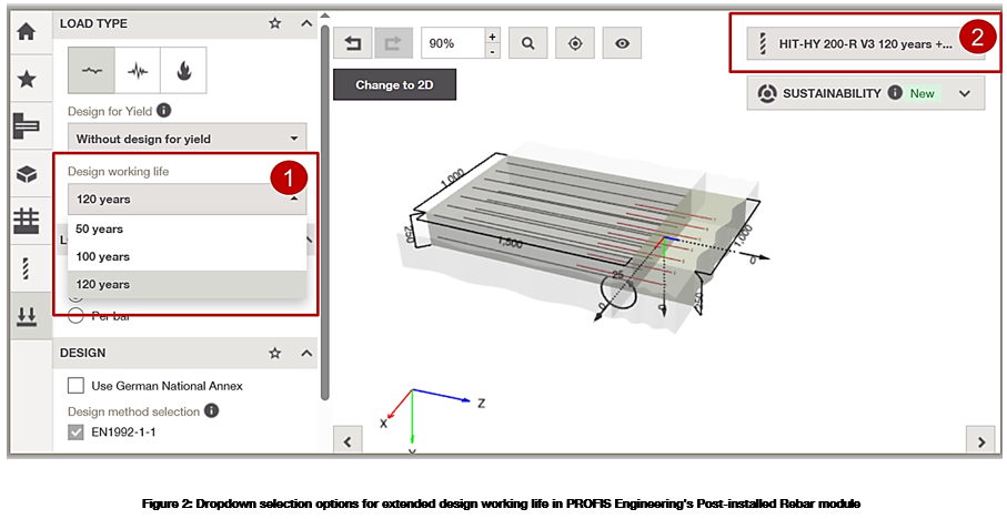

A similar option can be found in the Post-installed Rebar module for design of rebar equivalent to cast-in rebars or with improved bond-splitting behavior, illustrated by Figure 2.
Rebar
Design responsibility remains with the qualified structural engineer. PROFIS Engineering supports the application of ETA-based data within the design framework.
