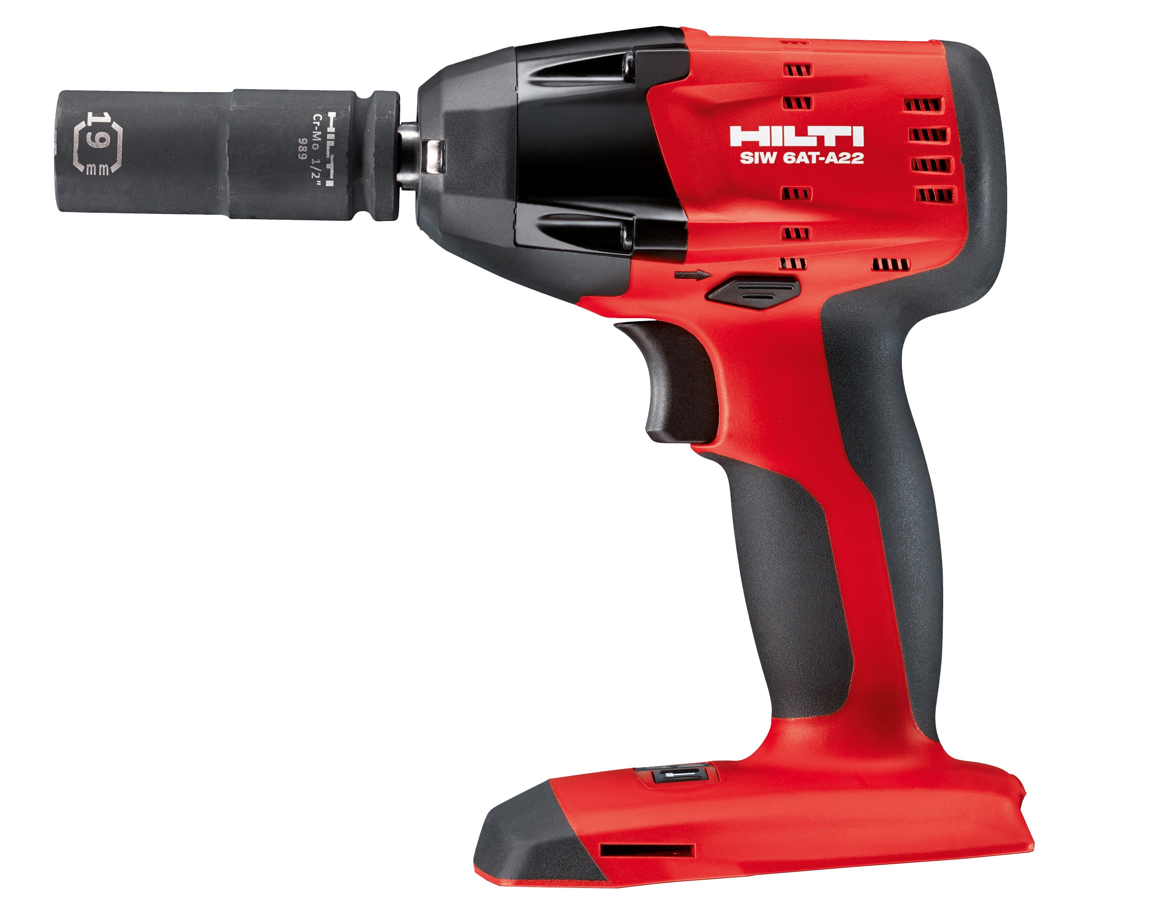

SIW 6AT-A22 cordless impact wrench with intelligent electronics.
SI-AT-A22 data processing module which slides in between the impact wrench and its battery. This number-cruncher processes data from sensors within the impact wrench to confirm that the nut is being hit with the right torque for the right amount of time.
