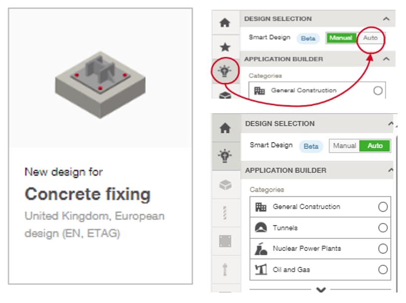

To start, access PROFIS Engineering at https://profisengineering.hilti.com; once you log-in, start a concrete fixing calculation by selecting the first module displayed on the Homepage, Concrete fixing. Once inside the module, click the third tab, “Smart Design.” Here, you can toggle on two modes of “Smart Design”: Manual, where you will get a recommendation of anchors, and Auto (exclusive for premium users), where you can exploit the maximum benefits from this new functionality. Please note that all button options on the left tab will be disabled, as you will have everything you need in this mode (read further).

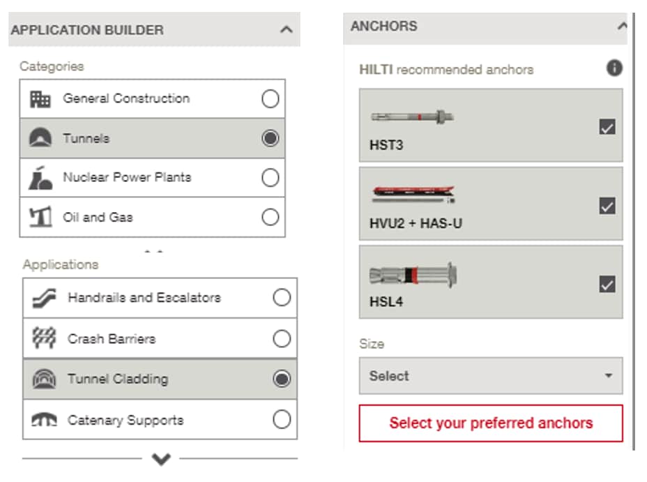

Following your input, our anchor calculation software will suggest up to three suitable anchors tailored to your specific project needs. As an expert, you have the flexibility to choose from these recommendations or select others based on your preferences. For further insight, simply click the 'i' icon to understand the basis of each recommendation, including technical approvals and practical applicability.
Note: To create this recommendation, we asked structural engineers which projects they spent more time on and which baseplates they designed more often. Based on this, our anchor experts match each application requirement with the specific approvals that could best meet those requirements.

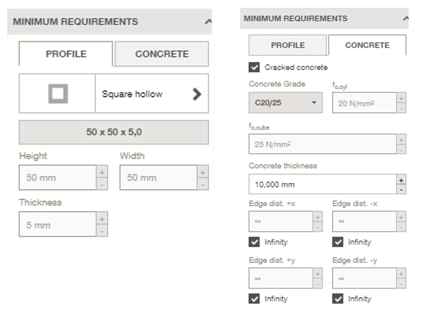

Once you have your preferred anchor(s) selected, you can include the minimum required parameters necessary to perform an anchor calculation, which should come as an outcome of your structure design. They are profile type, concrete properties (including geometry), and loads. You can include both geometries and loads directly into the model. Don’t worry if you don’t see the baseplate; Smart Design will use all the information provided to give you the minimum baseplate area.

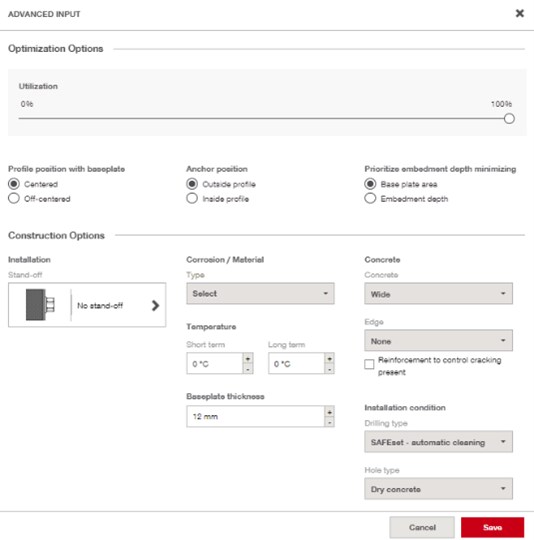

Now that you have input all the minimum information to design your anchors, technially, you are good to go, however, there’s something more you should try out. By clicking on “Advanced Inputs” in the bottom of the pannel, you will be able to unlock the full potential of Smart Design.
With just a few clicks, you can set your desired level of utilization—aiming for as close to 100% as possible. High utilization rates mean you're making the most out of your materials, which not only reduces costs but also speeds up the installation process. Adjust this setting to ensure your design is both resource-efficient and cost-effective.
Finally, you could use some of the construction options to narrow down the number of calculated solutions, giving you faster results.

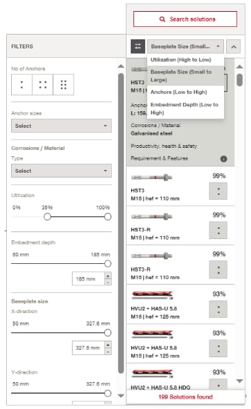

Once you are ready, and with a single click of a button (“Search Solutions”), you will notice that several solutions will come. The results count at the bottom will be displayed as they are calculated and sorted by smaller to larger baseplate area.
However, we have more than 100 solutions in this example, making the final selection a bit overwhelming. For this, we have equipped you with two handy options; first, you have a sorting option, allowing you to organize your solutions by utilization, baseplate size, and number of anchors or embedment depth, and second, with a filtering option that you can access by clicking this icon , enabling you to weed out solutions based on some of the parameters you know won’t be needed in your final design.
When clicking any solutions, the solution card will expand, giving you a glimpse of your final design before you print out your calculation report and send it to the construction site.
