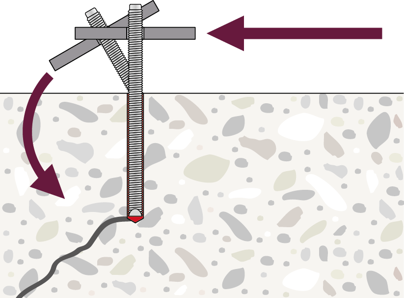

Another aspect for designers to note is that the calculation method does not cover the lever arm effect on the concrete edge. This means they must consider additional safety factors when calculating edge failure under this condition.
Lever arm effect on the concrete edge is not covered by EN 1992-4

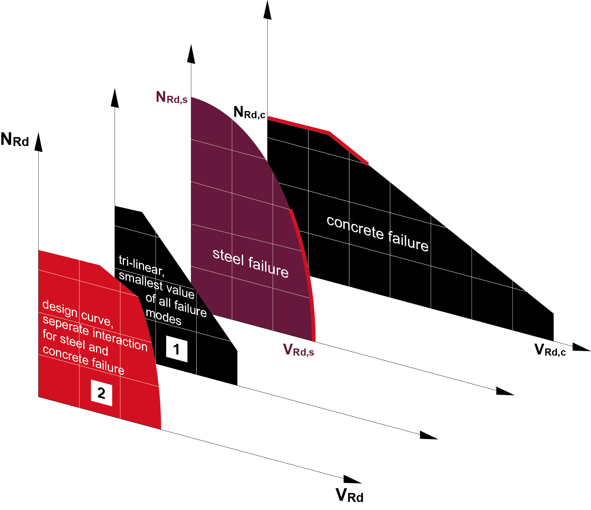

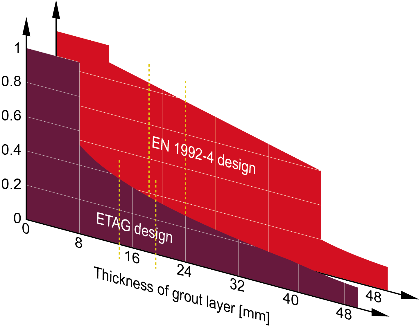

Change 8: Separate consideration of steel and concrete for combined tension and shear failure
When the resistance of combined tension and shear failure is calculated according to ETAG 001, only the worst utilization under tension and shear loads is taken into account, without considering that one may be steel failure and the other concrete. This approach is very conservative as ETAG combines two different failure types.
EN 1992-4 specifies that steel failure and concrete-relevant failure modes should be considered separately, thereby potentially delivering higher utilization values than ETAG, especially under seismic conditions.
