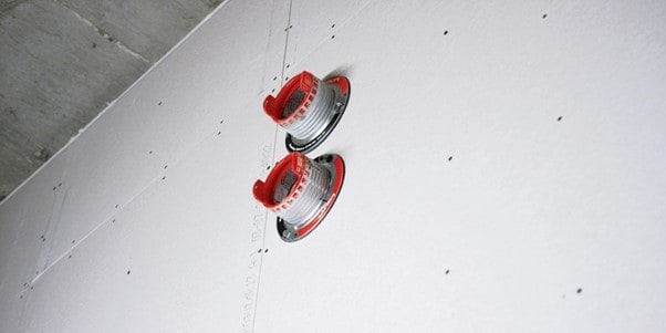

For electrical penetrations, the Firestop Sleeve is the optimal solution in the Hilti portfolio. In the next section of this article, we’ll show you why it is a smart choice for use in hospital environments.
Firestop Sleeve installed in hospital project

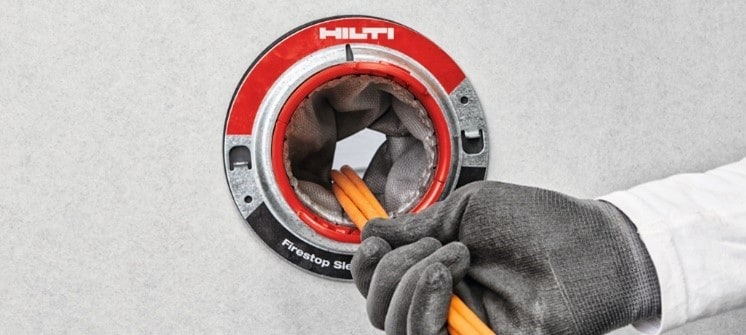

The Hilti Firestop Sleeve’s superior air tightness is a result of its twist-design. When the inner fabric liner twists closed, it wraps around an extended length of the cables, resulting in excellent airflow control.
Neutron ray imaging at Paul Scherrer Institute in Switzerland allows us to look inside leading firestop cable pathways and show that the Firestop Sleeve has optimal airflow control, with a performance of less than 4ml/s of air transmission.
