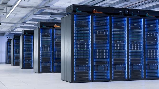

Despite the well-known threat that airborne contaminants pose to IT equipment, many data centers unwittingly design risk into their facilities by selecting traditional firestopping materials such as coated firestop batts. When these are repenetrated to accommodate frequent cabling changes, it releases high concentrations of particulate matter into the airflow. To help prevent failures due to airborne contamination, it’s important to specify fiber-free firestopping products.
Particulates endanger reliability and energy efficiency
As modern IT equipment gets smaller and smaller, it improves efficiency but also increases its susceptibility to problems associated with airborne contaminants in the data center environment.
According to ISO 14644-1 ­– the international standard for classifying the cleanliness of the air in cleanrooms and clean zones – most design guidelines recommend that data centers are classified and operated as clean room class 8 environments. Furthermore:
“Particulate contamination can increase a data center’s power demand by 2% or more.”
While achieving a 100% particle-free environment is neither feasible nor necessary, adhering to recommended contamination limits helps to protect sensitive IT equipment. Unfortunately, frequently used traditional firestopping products introduce a source of contaminants that may compromise data center operations, leading to energy waste and even to unplanned downtime.
