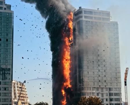

1.INTRODUCTION
Fire incidents remain a significant threat to life and property across all types of structures, with the potential to compromise the stability of concrete elements and lead to partial or complete collapse. Structural fire safety is therefore a fundamental requirement in all major building codes including the Eurocodes. Eurocodes prescribe minimum fire resistance durations for structural components and their connections to ensure safe evacuation, effective rescue operations, and controlled fire suppression among other fire safety related requirements (see Fig. 1).
