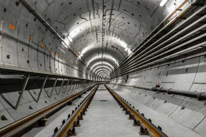

A typical scenario for extended design working life could be a road tunnel designed for 100 or 120 years. The design team may evaluate whether key components, such as jet fans for smoke and exhaust ventilation connected to the concrete tunnel lining using post-installed fastenings, can be designed reliably for the same period. For example:
·      Does the fastening of a jet fan to the concrete tunnel lining need to provide resistance for the full 120 years, even if the fan itself is replaced after 30 years?
·      Can the fastenings be designed to sustain the relevant actions for the full design working life without unexpected degradation in performance?
In such cases, the overall design philosophy is often to replace the fixture (fan) while retaining the fastening system. Re-drilling and replacing of new post-installed fasteners can be more time-consuming and may risk damaging the reinforcement within the tunnel lining. In such a setup, designers may choose a fastener to be:
